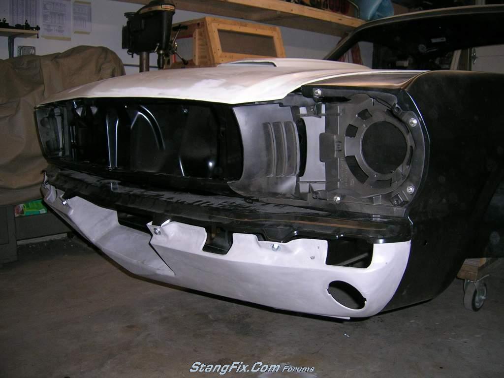

Slowly making progress on fitting panels on the scratch built body…

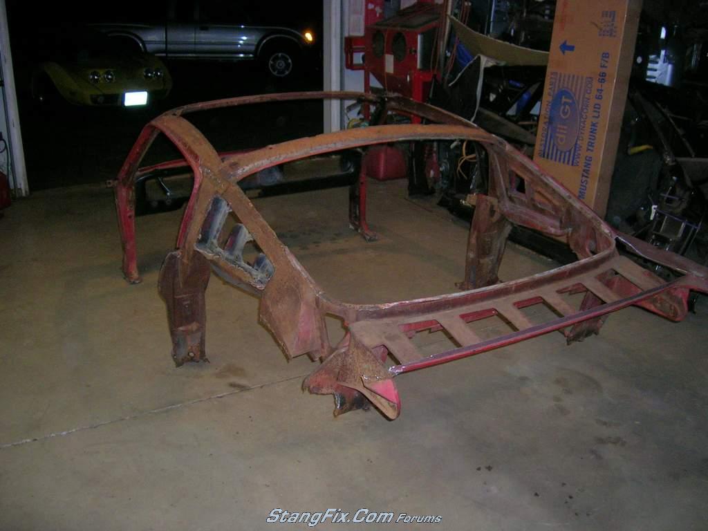

To recap, here is the salvaged:
The completed shell:
The doors, fenders, hood, valance, trunk, etc are rough fit…  the doors needed to be cut on the bottom edges some, the fenders needed lots of rework to fix the door gap, door to rear quarter was perfect, trunk lid needed some fitting as well…  next will be glass and glass trim test fit and door glass/trim test fit…

trust me, it is far from perfect... this is just getting everything in the ballpark.  while it is nice to have all new metal, it also drives nothing being easy and just working...  I don't know for sure if anything fits, so I am planning on pretty much building the entire car to check/fix fit on everything prior to doing final bodywork...  think about things like the glass and trim, it is hard enough to make that fit when you are just removing it and replacing, never mind after relacing the roof skin, cowl, quarters, and rear filler piece and loosing all the trim clip holes...
screw it, maybe I should just plan on fixing everything with greatstuff after its painted, that should work right?

incredible build. I like how you went with the shelby front fiberglass. how was the fit on all the fiberglass and where did you get the parts?

How long did it take you to go from your first pic to where you are now?

I had a post on the shell build a while back.  That was done last fall with a past co-worker of mine that now runs muscle car metal in seabrook NH.  he has been building 1st gen camaros from scratch for many years and is a dynacorn distributor. Got the parts through him (all dynacorn). Some were better than others, but generally all were great for the price.  This was his first ford endeavor.  We built it together and I learned a ton (he is way up the curve on build your own unibody techniques).  we adapted his camaro jig...  The shell was built in about 2 months, probably 200ish man hours (including alot of head scratchin and figurin time...).
It has taken me the rest of the year to get the body panels fit (2 small boys, no time)...  while working on random mechanical things at the same time, steering, suspension, rear...
