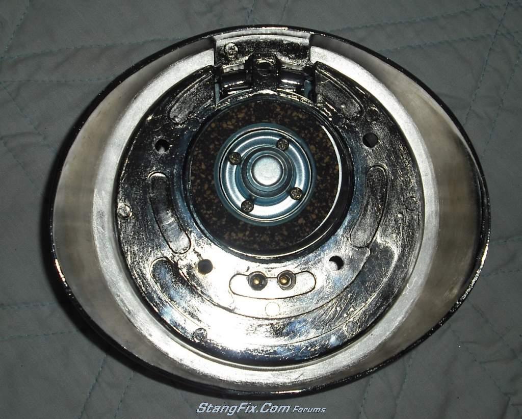

Doesn't the cork gasket go behind the filler tube?
Yes.  There is no gasket between the flip-down housing and the car filler tube.
Yes, you are correct (brain fart on my part). In my experience though, if you use one cork gasket behind the filler tube and one between the filler tube and the pop open gas cap, it keeps it pushed out just enough that you don't get the markings into the paint on the rear panel, but still sits flush.
I got mine today and it looks great.  I thought I'd mention that if you use a locking gas cap under the pop-open, you don't have to mess with any of the attachments that come with it.
I ordered my pop open from CJ's as well (just not at this awesome price unfortunately) but had an issue with the spring popping the cap open anytime the car was josseled at all. When I called CJ's they said it was pretty common and they recommend using the gas cap underneath it so you don't have to use the spring. I think the combo of the spring tension being too high on the replacement one causing it to pop too easily and the fact that the pivot mechanism you use to open it isn't long enough to fully catch on the inside flange of the cap surround (wow, I hope that made sense!) cause this problem.

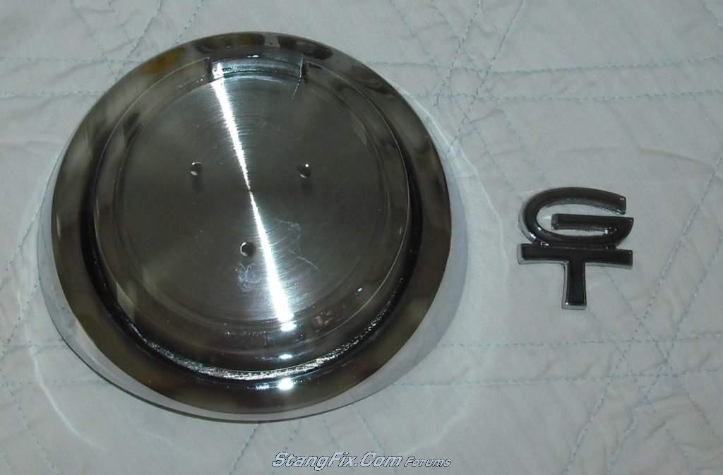

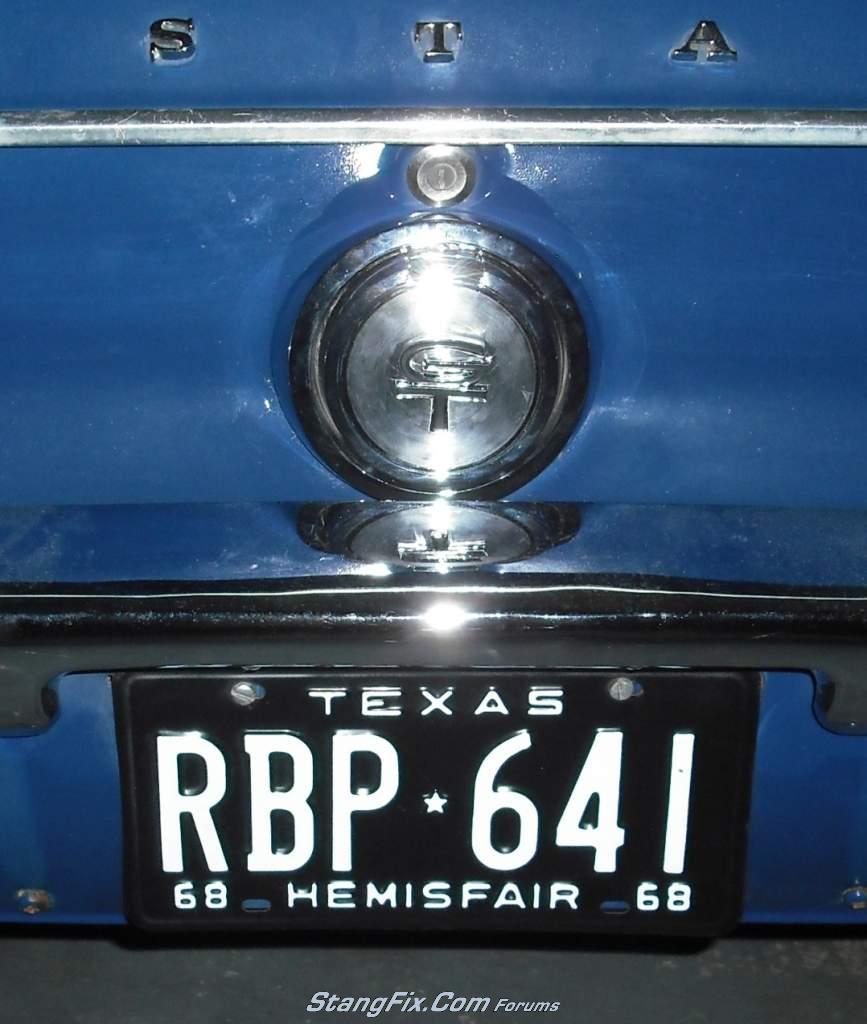

Got an emblem for my cap, I chose the 67 version.  I liked the black GT better than the red.
installed
