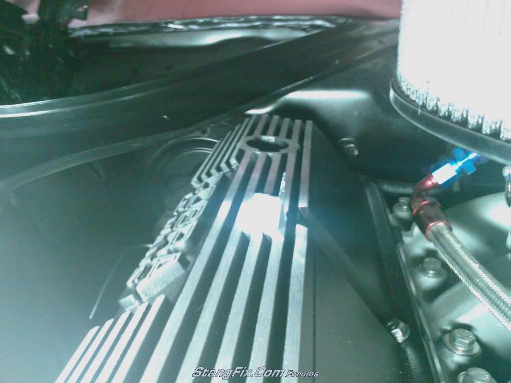

Well drat, since adding the FE-style valve covers to the 351 in my 67, there's no room for the PCV on the pass side of the motor (literally only about 1 finger of clearance.
I've got the stamped steel ones so looking at my options for the upgraded kind like this system from MPG:
The Total Control Products is nice but 30% more money, and harder to install (but maybe more effective).  Here's the whole system, that could be added to over time.
Any other suggestions?

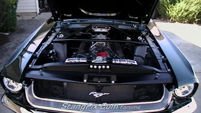

I dont know if it will give you anymore room, but I'm partial to my Maier racing piece. Dallas Mustang also has a really nice bar on the Terlingua Mustangs they built, I'll see if I can find a pic. They both mount on top of the firewall brace, so they should both be taller in the back than the TCP type brace as it mounts under the brace.

Not mine, the lower is the Dallas Mustang car, mines the top pic

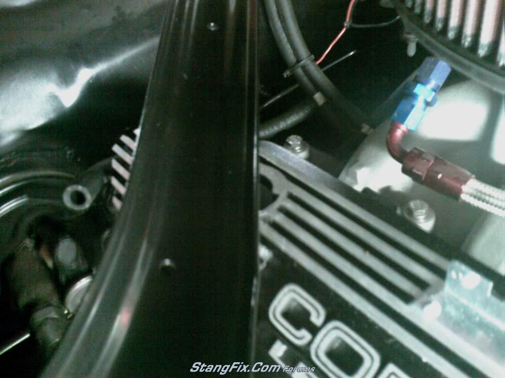

Yes, the FE valve covers are taller than my tall Motorsport valve covers, but the Breeze adapters add about 1/2" as well.
The big problem with the stock export brace is that it really dips down in the center of it to give it strength.  And because it's so wide, the edge goes right over the PCV connection.
I'm actually looking for an excuse to buy the cool ones, so it's all good.  Just want to know all the options before pulling the trigger.
Those TCP systems definetly are sexy.  The MPG ones look a bit flimsy.

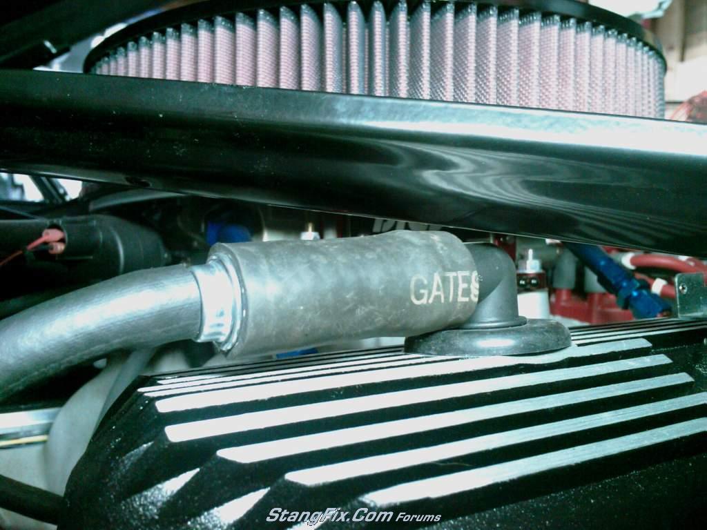

The PCV valve elbow sticks up about an inch above the valve cover grommet.
As a temp fix I'll probably just see if I can find a shorter one.
But of course, I'll still have to get some cool braces as soon as possible   :naughty

Yes, your valve covers are definitely higher than ours and I can see where you're having clearance issues.  Like Rick stated, installing the TCP style firewall brace is pretty straightforward.  After drilling the holes in the firewall from the engine compartment side, you'll just have to snake the support plate and a few nuts/washers up under the dash.  IIRC, this was one of those tasks where I called the wife out to the shop to give me a hand for a second.  With one person, it would have been very difficult the hold the plate in position (from under the dash) and then install the bolts (through the engine compartment).

Here's my temp fix till I get some cool braces.  I picked up this elbow, and an inline, not angled PCV valve.
