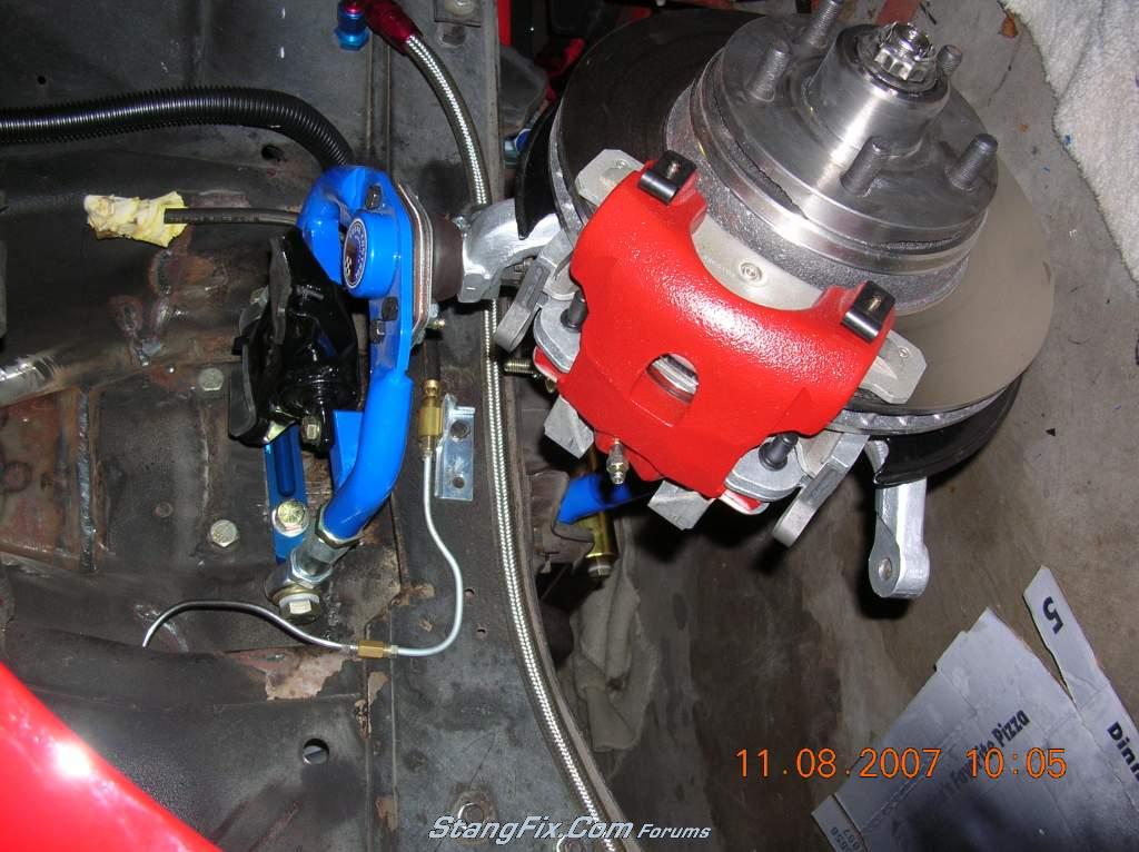

I need a picture (if possible) of a front disc brake set up to see where the brake lines bolt up.  My stang originally had drum brakes and the bolt holes don't look like they will work.

ok so the bolt holes you are talking about would be where the flex line attaches to the front frame rail right?
i'll see if i can find a pic, but if I recall I had a couple of holes in the frame rail that I could use.  And because the flex line had....flex, lol....i was able to move it around until I got it to work.

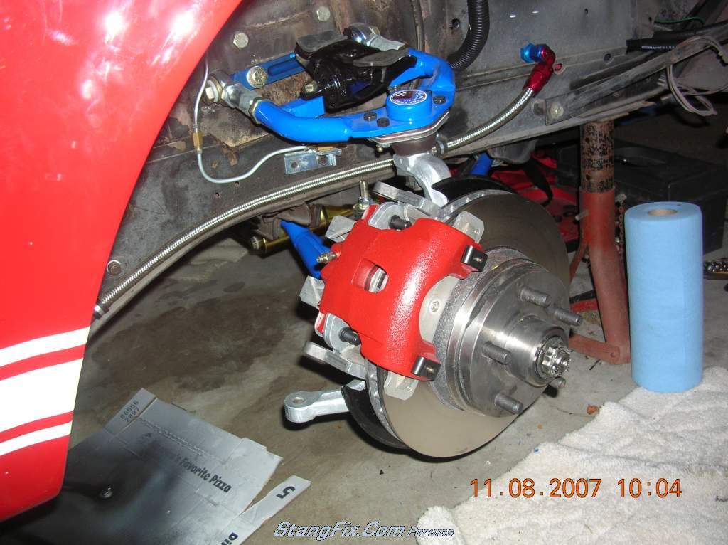

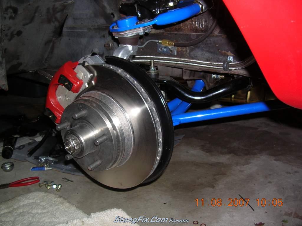

OK this is only on the pass side, but the drivers is very similar

EXACTLY what I needed to see! :notworthy: Guess I'll just have to drill some new holes! BTW, I Love your setup!
What is the long braided line running along the frame? battery in the trunk cable?

Great.
I've got as much of the Total Control setup that I can afford at this time   :doh
The braided line is a fuel line.  It made more sense for my setup to run it down the passenger side.
The black plastic shielded line is the line from the battery.
