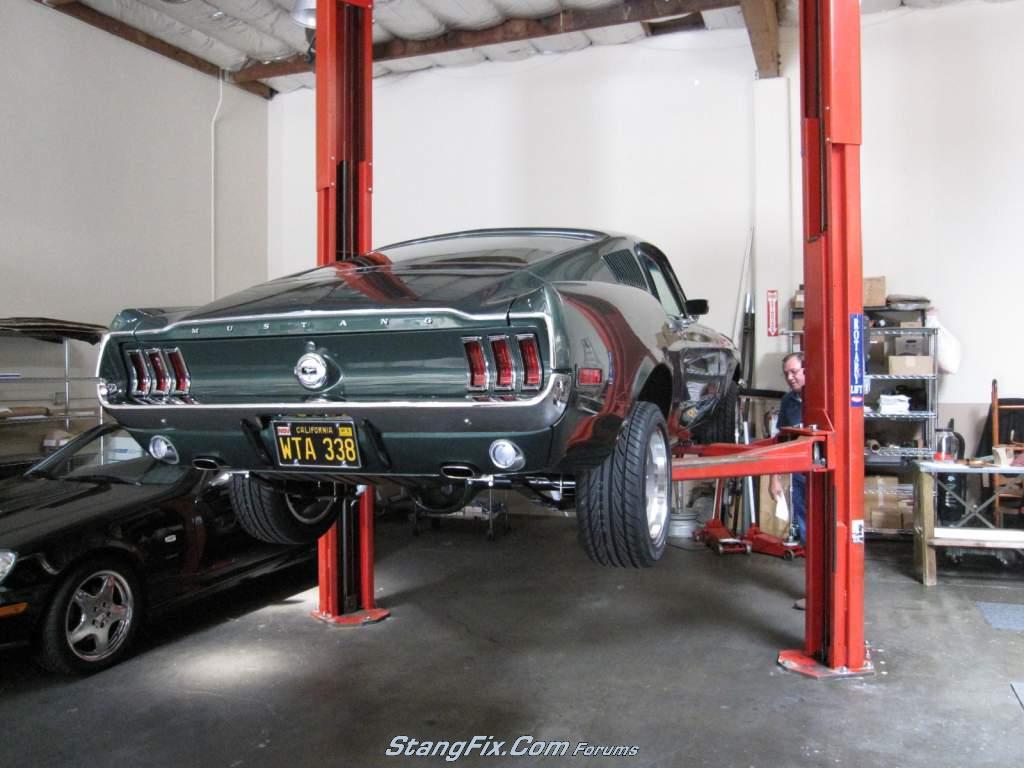

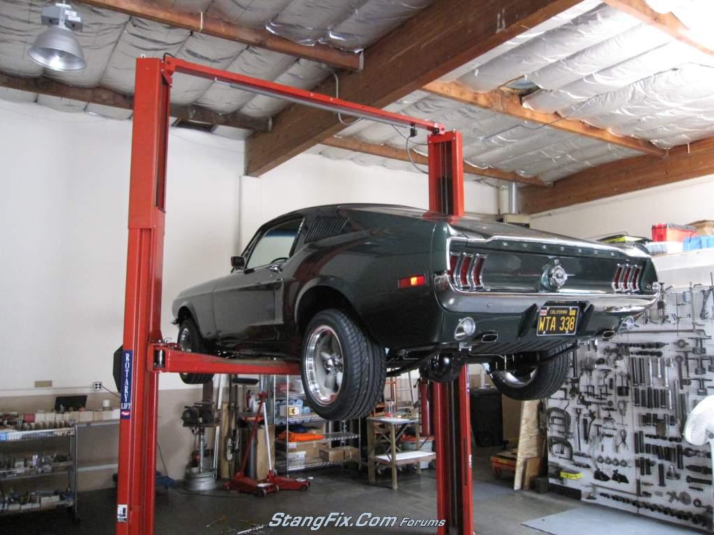

The turd is blocking the Italians from going back home so today we decided to test the car lifts next door by........raising Shag on one of them.  I spent 3+ hours under the car tightening this and that.  It was great to be able to go along and tighten down all the bolts and nuts starting from the front working my way to the rear.  I found some issue which I would have passed up had we didn't do this.  Trying to stick an oval front frame rail plug into it's hole with exhaust was impossible for me earlier so I kept it as a car lift "todo".  Went right in.  Best quality time spent on the car in a long time.  I'm  going to bring Red over to work to get a lift workout. The only thing I don't like is now my neck muscles are killing me from looking up so long.

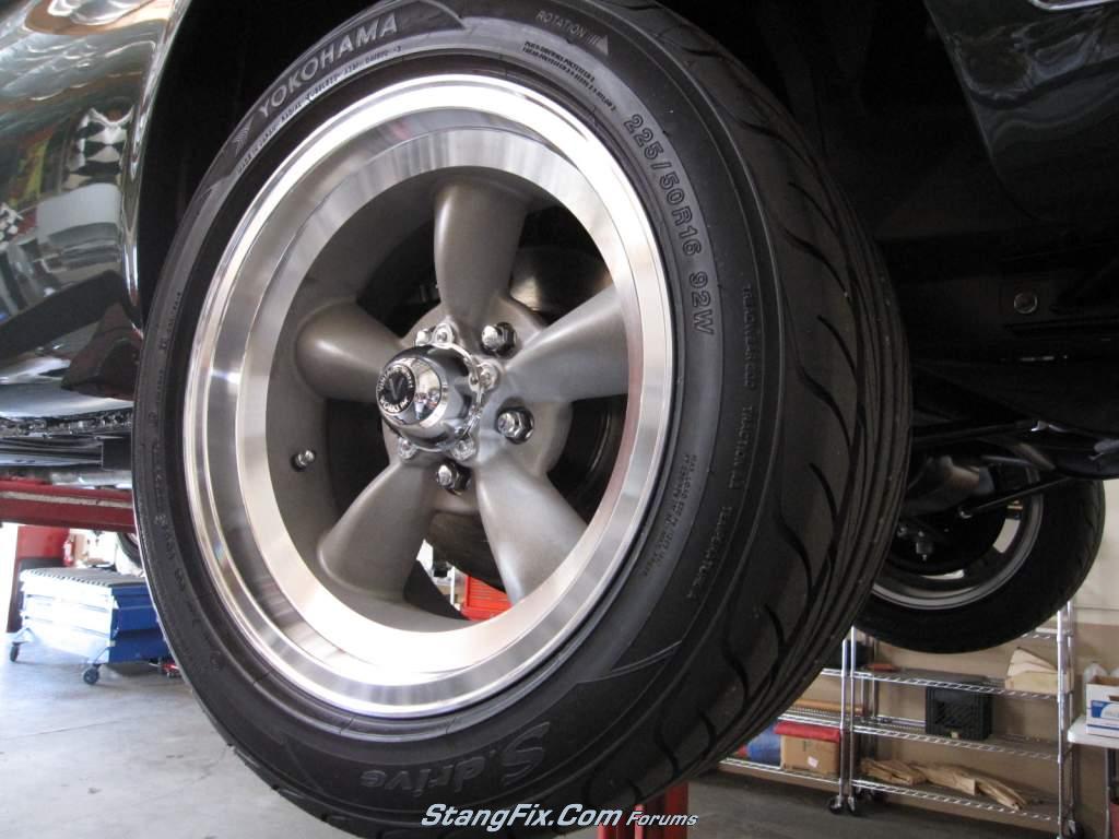

Here is a closeup of Shag's newest wheel.  Vintage Wheelwork's V45 16x8 with a 4.5" back space.  I love these wheels for you can remove them without having to remove the center cap as compared to American Racing.  Also love the Yokahama SDrive series tires (thanks JeffTepper for the suggestion).
With the American Racing 4.0" back space, I had a 1+ inch gap between the tire and upper ball joint.  Now I'm lucky if its more than 1/8" with the wheels hanging which represents the worst scenario.  On the ground this gap is more like 5/16".  So whenever I want to go up to SF and do those Steve McQueen scenes, I'll be ready.

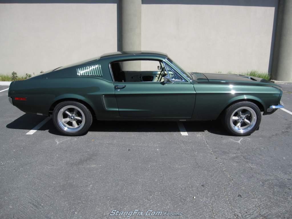

Today's stance after driving the car around the block a few times.  Still would like to see the front end down say 1/2" more.

I'd like to see a ground level/lower angle pic to see the side view and the ride height better, though.
I agree that it would look better a tad lower. But that's just me. :)

Looking real good. It could drop in the front as you said.

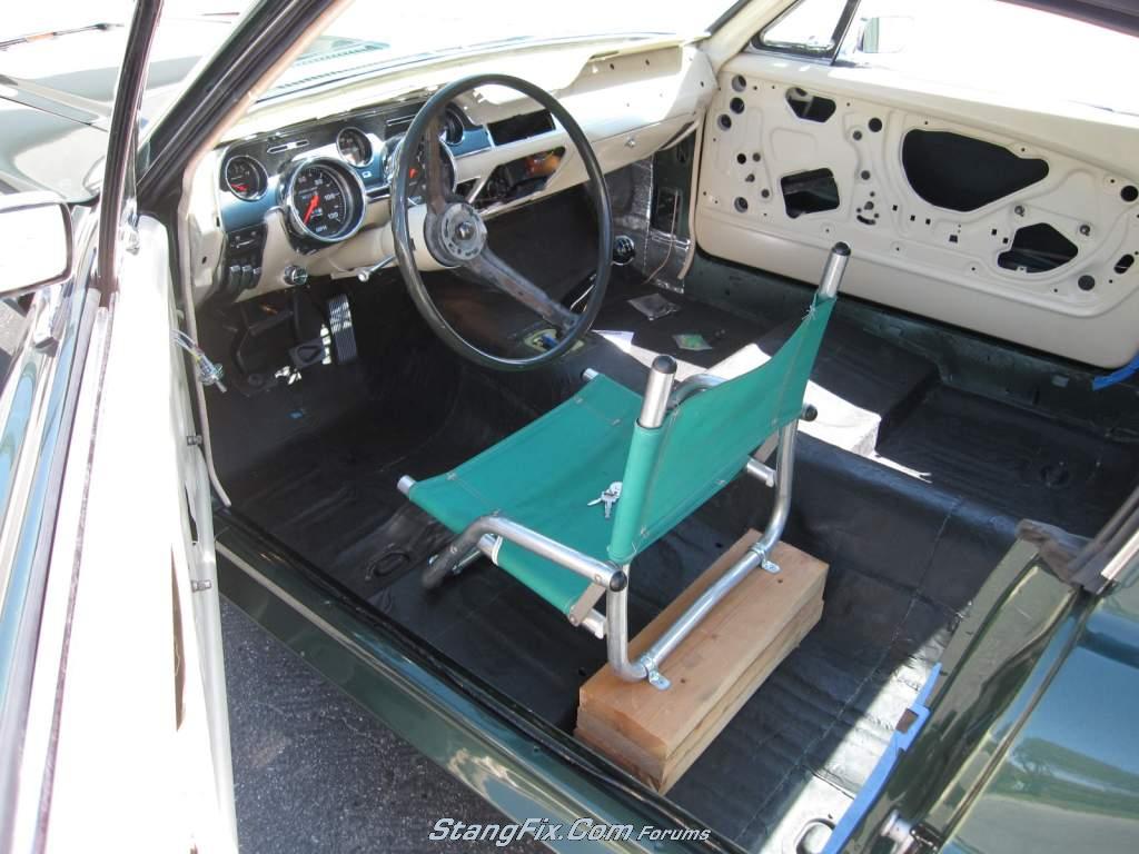

Yes I drove it pretty hard around the block a few times in our industrial park,  but until I get the rear view mirror glued to the windshield and maybe install some seat belts, I'm not going to mix with other motorists.  A couple quick observations:
1.  I need to add more weight to the car such as all the interior.  As you can see below, I don't have much. Pretty stiff suspension, especially in the back.
2.  Using a lawn chair that is too close to the steering wheel, I could not get comfortable.  Felt I was chewing on my knees and with a clutch, my left knee was working overtime.
3.  Power brakes-Though Red also has power brakes, there's a big difference for when I shut off Shag I lose LOTS of its braking whereas with Red there is a difference but it's more subtle.
4. T5-First gear seems pretty useless, unless you want to show off burnouts.  Though I wasn't able to drive too fast (still faster than allowed) I foresee 5th gear to be a treat on the highway.
5. Power vs Manual steering -  This has been one of my biggest worries.  I was very happy being able to turn those 225 tires up front with manual steering with about the same effort as I need in Red but obviously a little more effort due to 225 vs 205 (Red). My current crusty steering wheel is 15+ inches (almost a little too big for me), so if I go down just a tad, I think it will work fine. The main thing is to get a wheel with a larger diameter grip as compared to what I'm currently using.
Overheating? -No fricken way.  That Northern Aluminum radiator and mechanical fan kept it at 180.  Much cooler than my fire ups earlier.

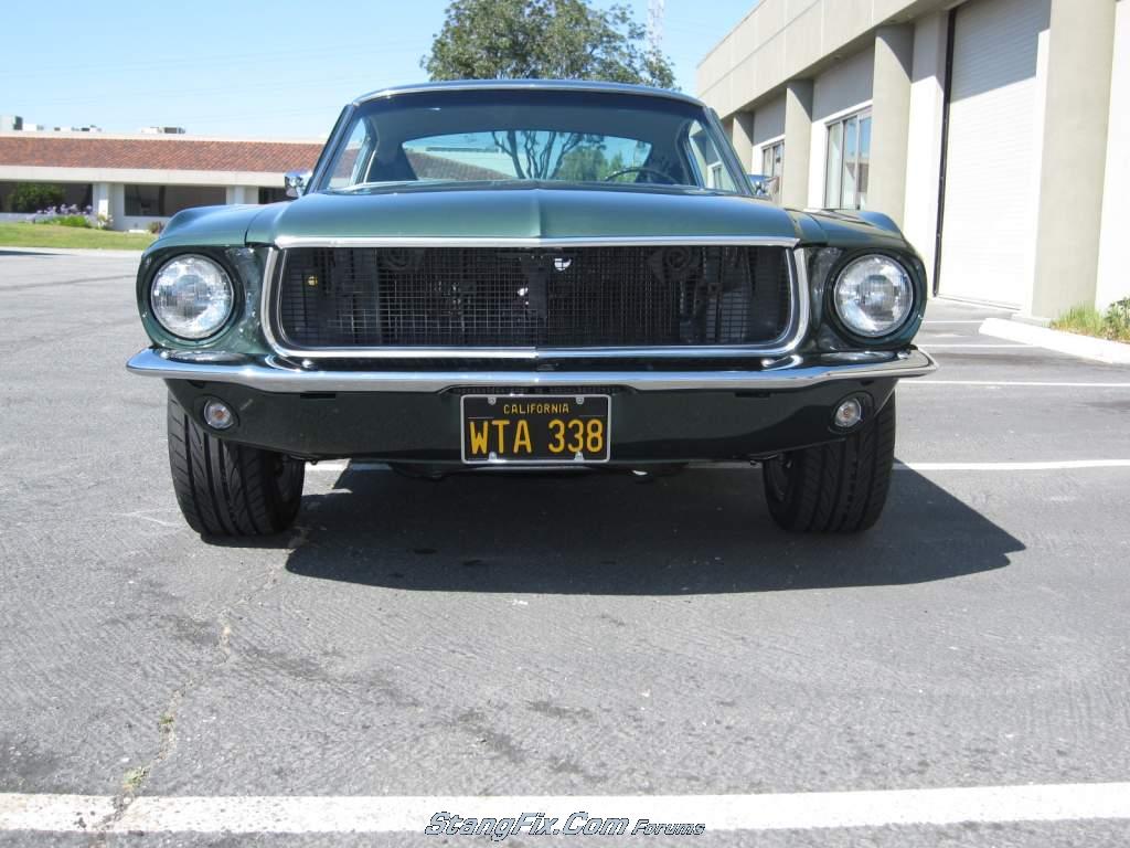

Just a quick question, is your hood angled down more in the center or is that the camera angle? I thought the center of the 67/68 hood was arched up rather than down...

His hood is OK. The angle of which the picture is taken gives a faulthy impression.

In regards to the inside lip of the wheels close proximity to the UCA....
Although I believe you'll be fine with the clearance that you have, some owners... maybe with less clearance.... grind off the the outside edge of the UCA to create a little more breathing room.  Your picture perfectly captures the possible interference issue.  If you'd have gone with 4.75" BS wheel, you'd have a problem.  A 17" wheel would move the wheel lip above the outer egde of the UCA.  Nice picture.
