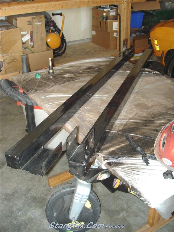

And to preface my statement...  based on the picture below.. it appears that the SFC on the right is the portion that cradles over the rear frame rail?  I am totally guessing on this - largly due to the fact the one end on the left is wider and seems to cradle the front frame rail extension and offsets to one side to align the F & R rails together...  is my assumption correct first off?

Not sure on that one. They look a little too straight. Do the fit the floor tight?

They are straight - the floor pans are contoured, as you are well aware.  I did google some images and the tinman ones don't hug the floor pans tight either - but they are a bit countoured, as where mine are 100% straight.
The tinmans fit the floor pretty nice.

But you're not physically attaching the SFC to the floor pan structure - you're attaching to point "A" & point "B" at each frame rail.  So if they hug the pan a little tighter then the straight ones - I see no added benefit other than 3/8" ground clearance...
Now if I was tabbing off and welding TO the floor pans.... that'd be a different story.
correct?

Yes, unless you are actually welding to the floor, it's only a clearance issue and how much you will the SFC from a side view.
I assume both your front and rear subframes are straight enough to allow the SFC's to slide over?  Red's front frame rails were all distorted from the PO using a bottle jack too many times to change a flat.  Trying to pound these rails flat while on the ground was impossible.  That is why I had Maier install them.  They spend a fair amount of time getting all the frame rails nice and flat to allow the SFCs to slide over.

The back SFC's didn't want to slide over the rear rails to well though - I think they need to be opened up a bit.
And Craig - is my orientation assumption correct?  Sounds like you use similar ones on Red?
