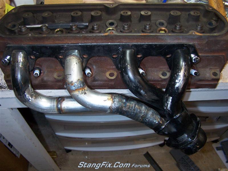

So, I picked up a set of Hedman shorties from Summit - $150 bucks, with ball sockets and header bolts. Great value, advertised as 18ga, but these measure out as 16ga steel. No starting pic, but here is the Hedman pic:
The issue with the P heads is the plug angle. Most headers come back sharply from the front drivers cylinders, which hits the plugs on a P head. You can see that on the left header in the pic above. The left side barely touched the front plug, but the second plug hit right in the middle of the tube. No way tighten them down w/o breaking the plug, much less get wires on them. Right bank needed no changes at all, perfect bolt up.

I also picked up a couple of ½ inch U bends from Summit. Some thinking, thinking some more, and then I just decided to cut. Lots of sawing, fitting, filing, and welding later, I had the headers fitting, with at least 3/8” from the plug boots to the tubes. With heat shields, I’ve had good luck with that distance.
All welded in place. You can see the third plug is the tightest, but it should be fine.
The welds aren’t the best looking, but for my first TIG job, I’m happy. Full penetration of the 16 ga and only a couple of voids I had to fill – I ran 40 amps the whole time. I love how you can turn down TIG - I tried welding 20 ga butted with no problems & NO FILLER at 35 amps. I also found out that even though TIG doesn’t throw sparks and slag like stick or MIG, you still need to wear good welding clothes with long sleeves. It’ll give your forearms a wicked sunburn.
