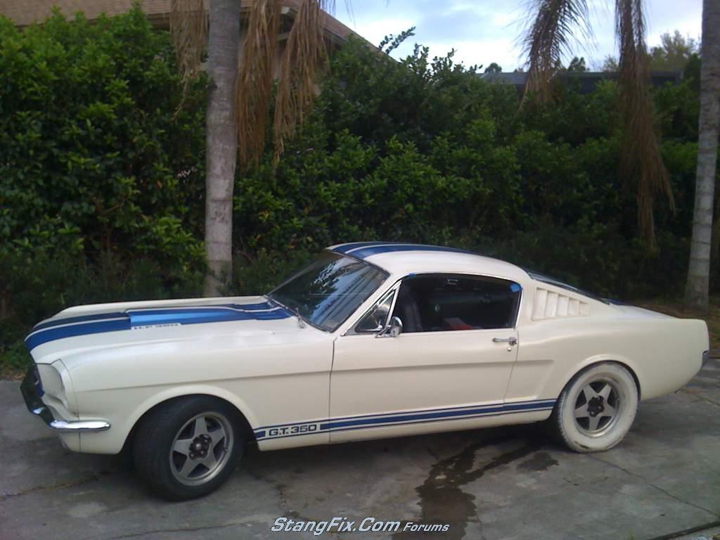

 Here is the deal. I ended up buying shocks Gr2's. I had a set offered to me free if I paid shipping but I live close enough to NPD and I only have one more week of time off.
Get this. I took Those load levelers off and a cup of oil pored out of each one. THEN the rear settled with  The exhaust one inch above the axle swallowing the rear tires. The springs were almost reversed , flat for sure.
Question. Do I want Mid eye?
Question. Bushings. Midolyne, Polyurethane, Prothane or rubber ?
Steer me right Please . .
Note: car has not been sanded and Buffed yet

That's a nice paint job you did there!  :coo   I really like the new look of the white out back tires...lol.   I know, I have an old set of tires that I use for painting too.   :vic
