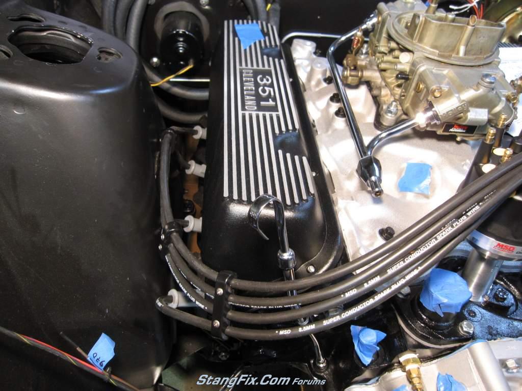

Is it ok to possibly lay the plug wires up close to or possibly touching the shock tower?  These are MSD's 8.5mm super conductors that I'm stringing up.
Offline AzPete
  • Classic...less
  • Posts: 9288
Re: Routing of spark plug wires
« Reply #1 on: January, 16, 2010, 05:49:45 PM »
It will work but it will rub the paint off. I doubt it will be a running problem since the car will not see the street but twice a year or so.....
« Reply #4 on: January, 16, 2010, 06:51:33 PM »
you could always just bolt one of those loom seperators in to keep everything straight and tidy.  They just bolt right to the valve cover. Although im not sure how available they are for a clevo.
Actually the loom kit comes with the vertical holders that do infact fasten to the valve covers but I  didn't like the routing to close to the valve covers,  or I think so anyways.   Need to look at this again.

« Reply #5 on: January, 16, 2010, 06:54:23 PM »
Craig, that's how I have mine running and I've not had a problem in 5 years. It's much easier to remove the valve covers with the wires not fastened to or running over the VCs.

I already posted this pic but here it the final product......for now.  Rick I had planned to use the Taylor looms in a vertical position on the valve cover (actually have all the parts) but felt while the motor has yet to be fired up, and possibly having to get into the valve covers, I didn't want to deal with the wires.

Craig
First , nice job you did !
Second , isn't there an issue about when lining up the ignition wires , you should check the firing order from your engine and make sure that those wires who fires right up after each other , not suppose to be mounted beside each other due to magnetic field they create and misfire occures????
I did read something about this fenomenen.
Bruno
Offline AzPete
  • Classic...less
  • Posts: 9288
« Reply #24 on: January, 19, 2010, 12:57:55 PM »
I read that too.... Tried both ways on my 302 with no difference. I think the quality of wires makes a difference.
