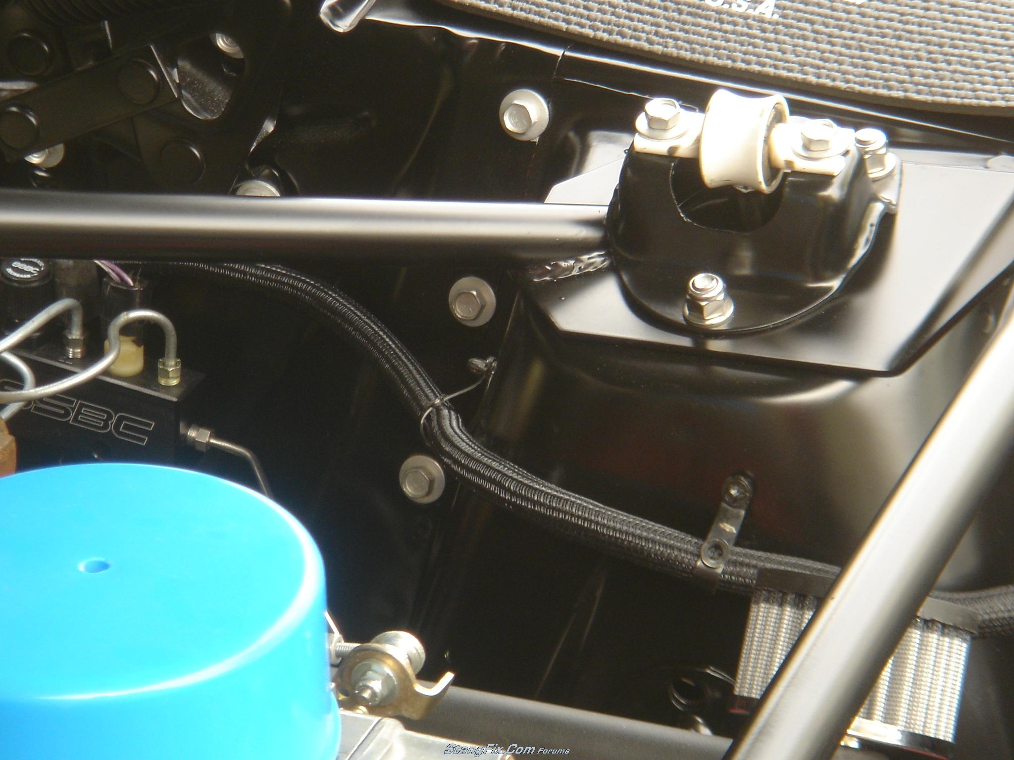

While I like the looks of the TCP type setup (the new one from Street or Track is really sweet) I like that the Maier racing pieces do not require new holes for mounting the MC bar. I would think you could fab one up if you had any kinda fab skills and save a lot of money.
Maier has a one piece MC bar and a one piece combo MC/Strut brace
mine
