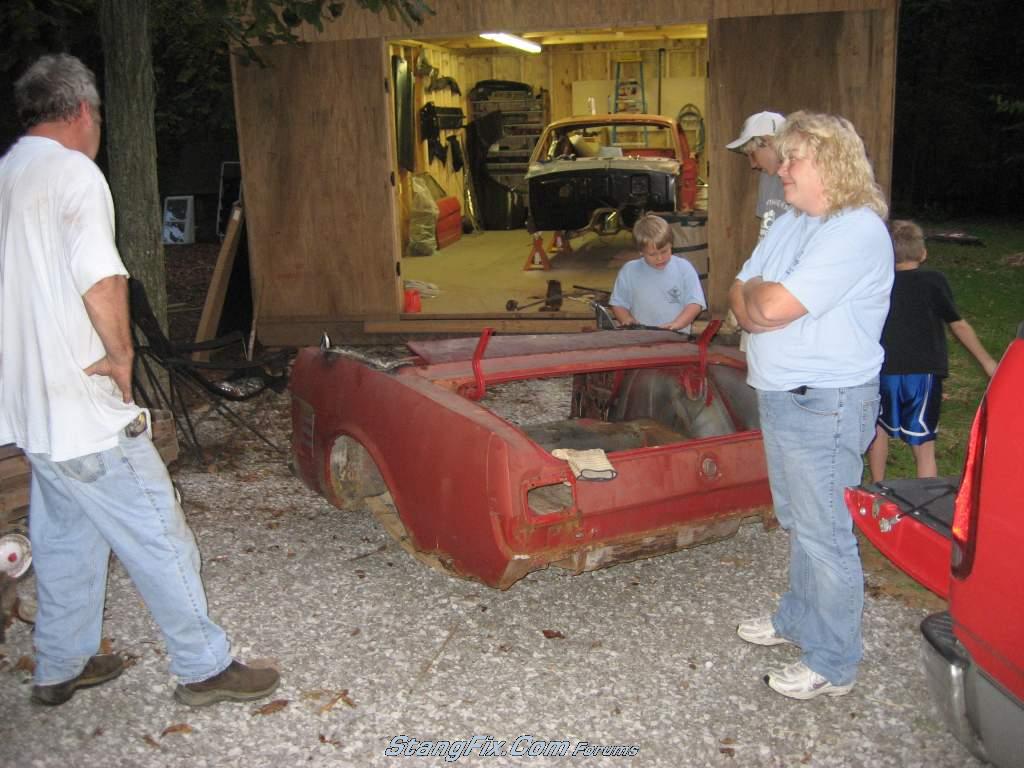

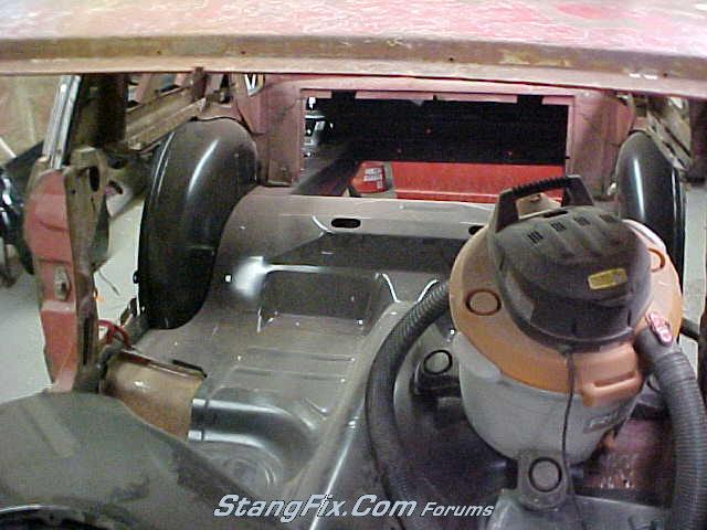

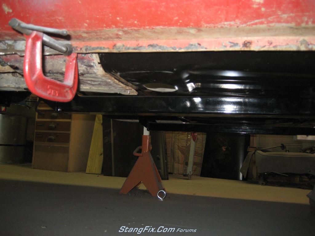

I don't know if I can help you much but we did pretty much the same thing with my buddies 65 FB.
Here are some pics:
we actually used frame rails from a doner 66 coupe, everything else was repop stuff.
we kept the frame rails and torque boxes in tact and welded them to the original rockers (about the only original part left!).

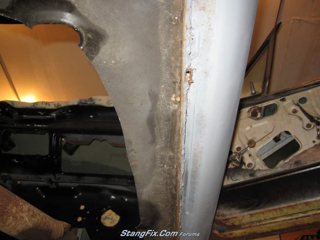

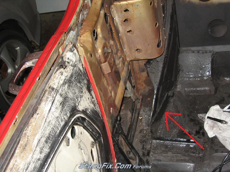

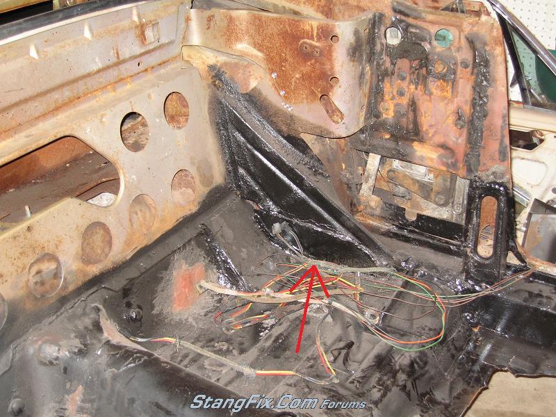

Btw, here a couple pics of those gooped up welded areas I may have some troubles seperating.
I just want to make sure I try to save sheetmetal they don't reproduce.

hmmm... I have never had a vert. I see what you mean. Lots of extra stuff in there. Is that "previous owner" added sheet metal on the brace? Is that black stuff under coating or paint? Do you have a plasma cutter?
Offline my68vert
  • NewB
  • Posts: 15
Re: Over the axle transition sheet metal
« Reply #6 on: October, 30, 2009, 06:29:53 PM »
Thats a good question on if that's "added" sheet metal material, I can't find another detailed pic of that area for a convertible yet to see. I do have a plasma cutter so that may be my way to knock it out. I wish I was able to just drill out spot welds lol

after wire wheeling those areas I have pointed out above I think those may just be some crappy patches some tried to make. Maybe that will make it easier on me now that I can cut those out and redo it properly.
