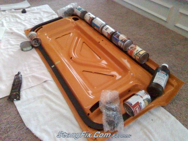

Use canned goods to apply pressure and hold the seal in place while the sealer cures:

I'm particularly fond of the tuna can supporting the soup can.  That's engineering!
LOL!  I was out'a cat food cans.
And can you tell what's in the bubble wrap bag at the bottom?

And be sure and put towels down to protect the carpet, but only put the trunk lid half way on the towels......
That side was done.  I could safely move it off of the towels.  LoL.
Oh, and don't use white towels like I did with the black adhesive...  :doh
Do we really want to know? :zip
Looks like a figurene of some sorts.  :conf

It was actually a new hood hinge spring.
That was my second guess. :danc
