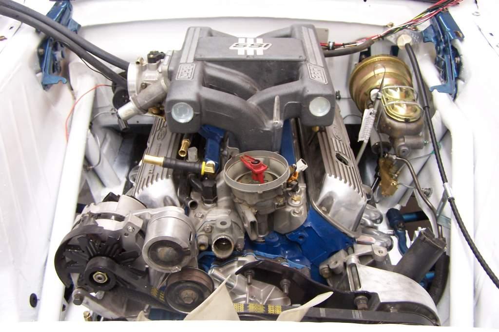

In my '66 with shock towers removed, ut it should give you an idea of the cable length/routing....

thanks Dave.
nice looking engine bay btw!

That was fresh paint just after/during engine installation.  Trust me, it ain't that pretty anymore.  Painting the engine compartment white was one of the dumbest ideas I've had!
