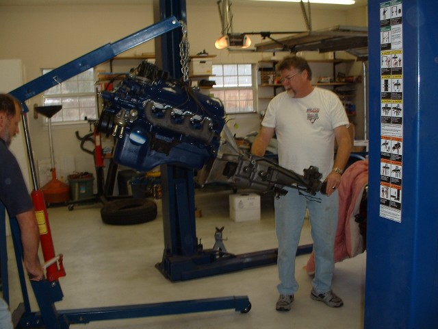

Okay, here are some pictures of Trouble's engine installation that we did last week.  No, it's not working yet, but it's in there!  The last picture actually took place before the others.  We had to do a test fit to make sure the oil pan cleared the rack.  It did then, but once the C-6 went in, the 390 hits a spot on the rack.  I need to either lower the rack or raise the engine.

 Engine lift question:  Your 2nd pick shows being hooked up to a fancy plate mounted to the top of the carb.  What is the purpose of this type of hookup?  I can't imagine you putting too much stress in this area.  Just to keep the engine level without a tranny cross member installed?

That's an engine lift plate, which we used to move it from the cradle to the hoist.  We had to do a test fit before putting the C-6 on, so we also used it for that.  While installing it as a unit, the plate got in the way of the chains, so we removed it then.  It's a good way to lift an engine, but not when the transmission is also hooked to it.

Neat idea but that still looks like too much stress on the intake.  Yes, I'm old and overly cautious.

Grade 8 bolts threaded into the carb stud holes is plenty of lifting strength.  The engine really isn't that heavy when compared to the tensile strength of hardened steel.
