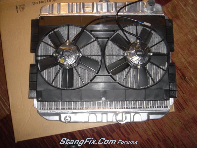

Online Fast68back
  • Posts: 7473
Re: Runs hot when stuck in traffic
« Reply #7 on: April, 23, 2009, 07:21:15 AM »
Why not use a dual puller setup like I have, the fans are offset allowing the room for the waterpump pulley.

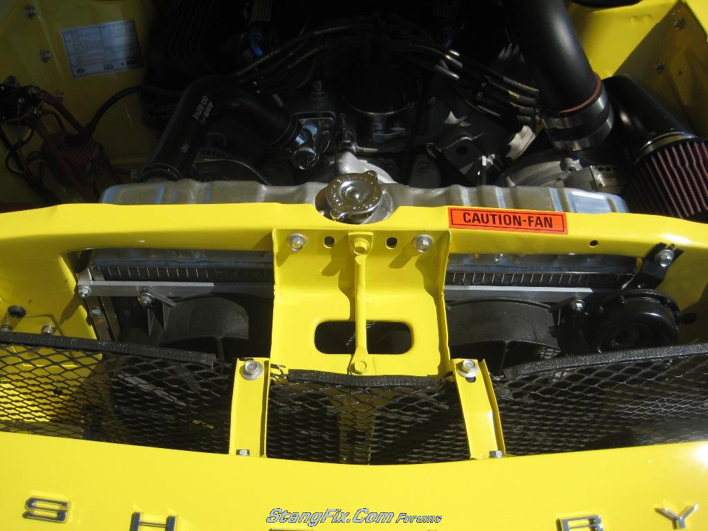

I have similar problems with my 514 except I have the monster custom built aluminum radiator, dual pusher fans, each putting out over 2,000 cfm, they cover 90% of my radiator. I run straight water and water wetter. we have too much motor and no air flow around them it's a furnace under the hood. I actually have the opposite problem, mine will warm up on the freeway, ( i think it's because the fans are blocking the natural air flow) and then when you get off of the freeway she cools back down. I'd try adding a second fan or maybe a shroud on your existing to contain the air flow, I don't know if the water and water wetter combo will make a huge difference, and I'd be careful about increasing the pressure of your radiator cap it tends to stress the whole system.
I've actually been thinking of installing vents in the back of my hood to help release the built up heat in the engine compartment, similar to the new shelby GT500's.

Well, Thanks to Rick for his post on this thread, and his superior supreme being advice :wor, I purchased the Griffin radiator for my C4, and the cool Dual elec. fans!  :mj  Purchased from Old air. OMG, the guy that I ordered from really wanted to sell me his AC system! But I bought one already and it's 75%installed, He says, "take it out!"  :rofl  "NO", I say! My husband would shoot me!  :bike
thanks Rick!
