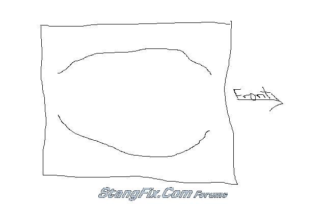

So I've had my fastback for 4+ years now and I just noticed this today.  I finally got around to stripping the multiple layers of paint, primer, filler, etc from the roof and noticed this:
I know it's not much of a drawing but it gets the point across.  This is the roof panel with the front of the car to the right.  The arcs are the high spots in the panel, giving a huge crater in the middle.  I don't have any idea what happened; it's almost like a child walked on the roof or something heavy was stored there.  It's VERY obvious by feel, and pretty obvious by eye.  Being an amateur bodyman, my best bet might be to replace the roof skin rather than attempt to fix it.  I'm gonna play with it a bit and see what I can do, but.......bummer dude.
-Ryan

What a bummer. I know from past experience that is a pain to fix. My last '66 had a couple of small ones in the rear and the body man did a lot of complaining but did a good job. Two things, getting out the small crease where you drew the lines and keeping it from "oil canning" due to the metal being stretched. Good luck.

Well, I can only do small areas at a time, so it won't be quick.  However, I just need to shrink the arcs in my picture above, and this should allow me to do that.  I also have a dented up decklid that I will practice on first.

Well, good news.  I spent another couple hours today improving my shrinking skills.  I heated up a small dime sized area with my MAPP torch, until it started to turn blue, then lightly hammered the spot with a body hammer.  You wouldn't believe how much the metal expands when it gets hot.  You can actually see the metal raise, forming a dome.  Anyway, then I quenched it with a wet rag.  I'll probably have to do this procedure hundreds of times over the roof.
What I've come to the conclusion of, is not that my roof is really caved in, but there is a thin circle of raised metal around the top.  This probably happened over the years of having things stored on the roof, and the metal popping in and out.  With my amateur body and shrinking skills, I'll be able to get the high spots out, but I'm sure the roof will require a thin skim coat, or at least part of it.  I'm cool with that.
