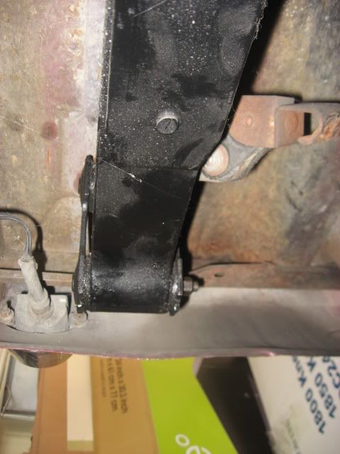

Offline Jonk67
  • Yak, Yak, Yak
  • Posts: 1028
  • Smyrna, TN
Re: Leaf Spring Shackle Frame Mount
« Reply #7 on: September, 06, 2011, 11:17:38 AM »
Here's a couple pics if it helps any:
Jon

Offline 65fast
  • Active Poster
  • Posts: 227
« Reply #9 on: September, 06, 2011, 04:29:14 PM »
Thanks for the pictures.
