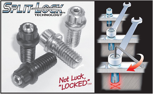

Well, I got around to replacing the header bolts with the stage 8 locking set. Nice quality items and easy to "adjust" to fit. I have no complaints concerning the install of them.
Now, two freaking hours for ONE bolt install is just plain stupid....... I did the passenger side in about 1 hour 20 min. taking my time. Easy job. Went to the drivers side and removed and replaced one at a time as I did on the first set. Got to the rear most header bolt and it came out fine. The new one would not start straight. All in all, I removed all of the others and tried many ways to get that one in. Finally, the correct combination was to start the very front bolt, jack the engine/tranny on the right side, pry the header out and start the bolt. Not sure of the position of my left hand or mouth so I cannot say this would work for anyone else. After that, 30 mins. to tighten, set the locks, and test run.

Anyone using these header bolts?
http://www.route66supply.com/store/page53.html
Looks like these would be easier to install than the Stage8 bolts.

On the Hooker Comp. headers I have. you cannot get a box wrench on half the bolts on each side. I must use an open end wrench. Then, on two, you could not get the allen wrench to fit into the bolt.
