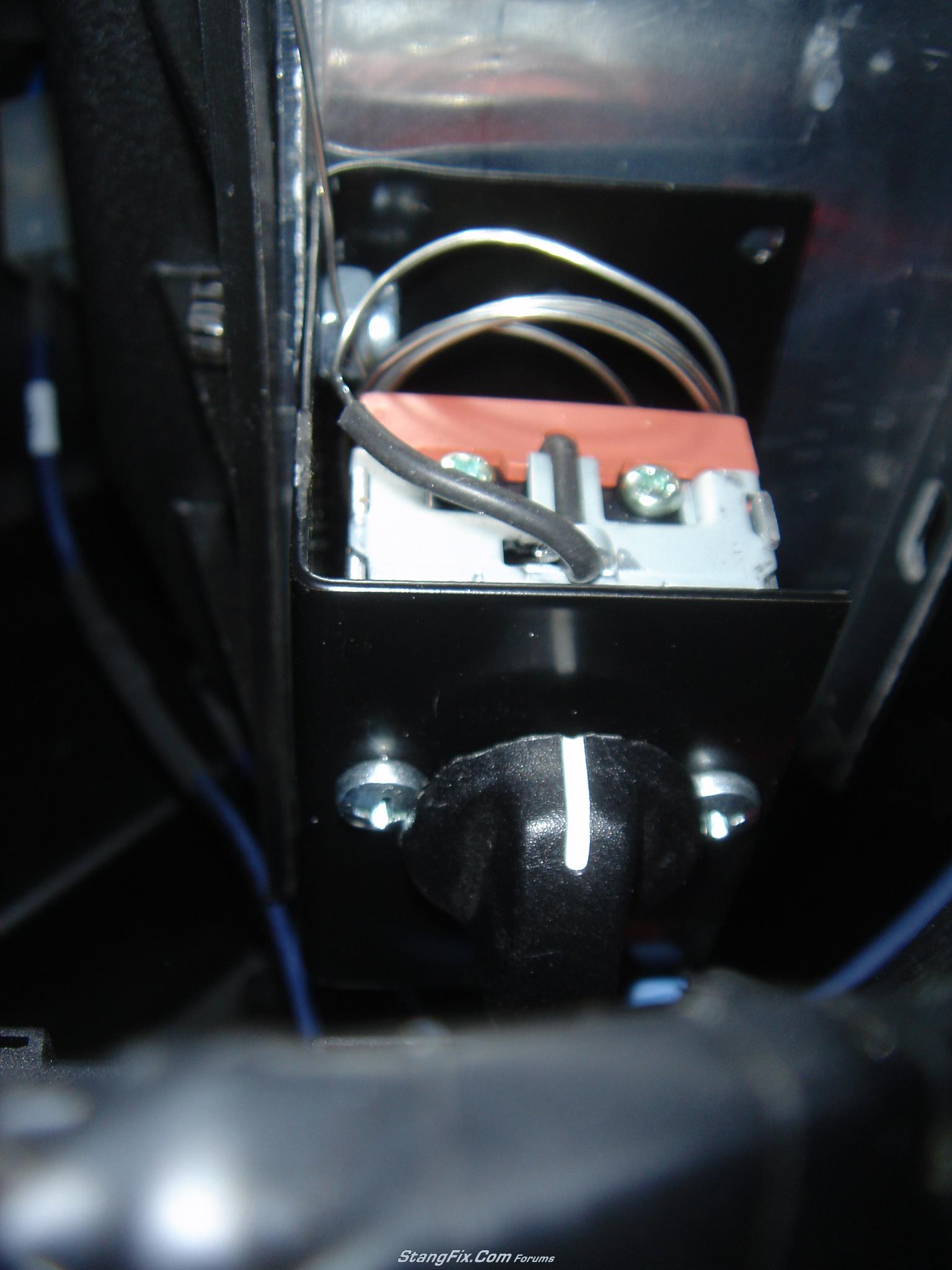

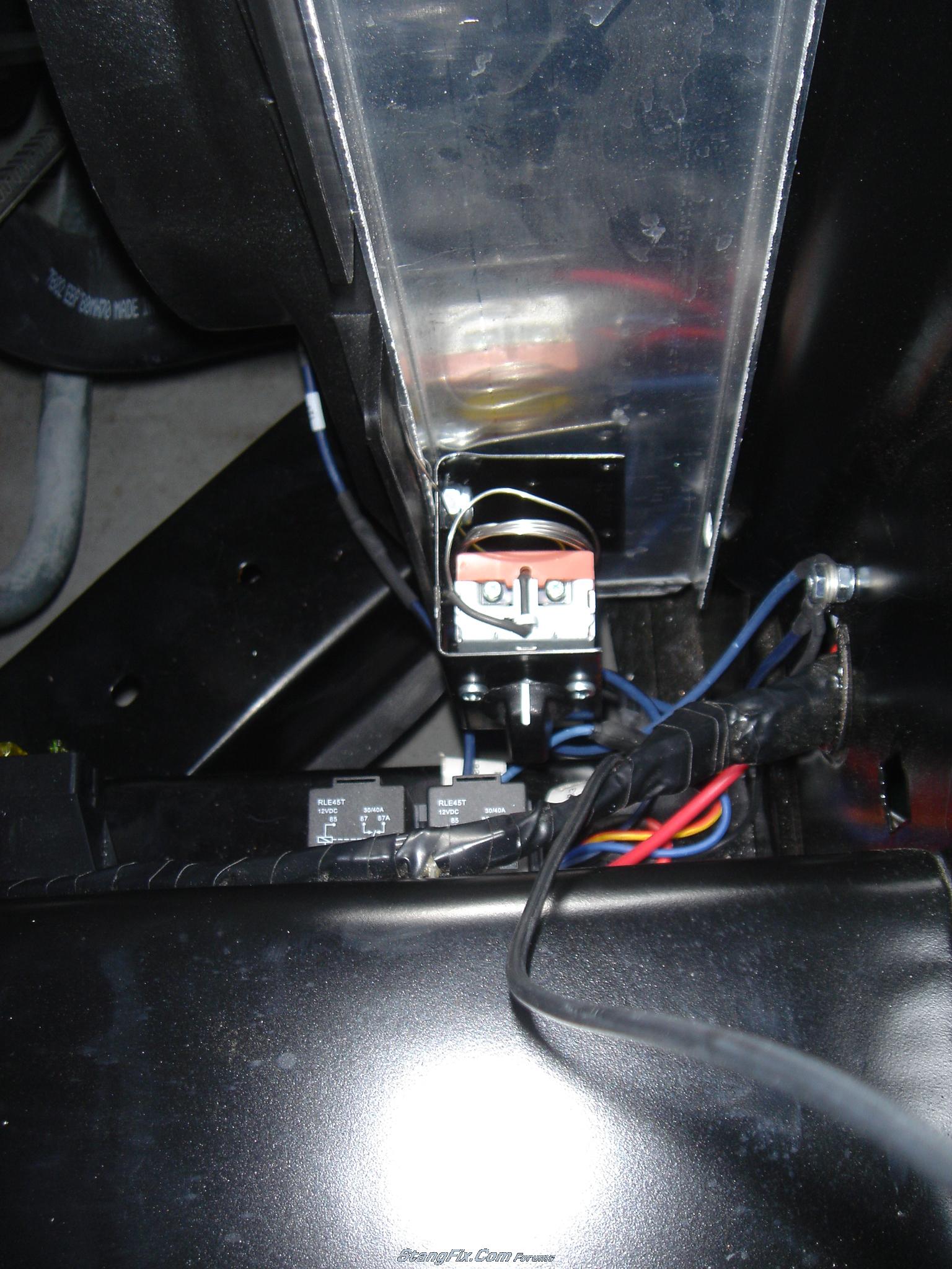

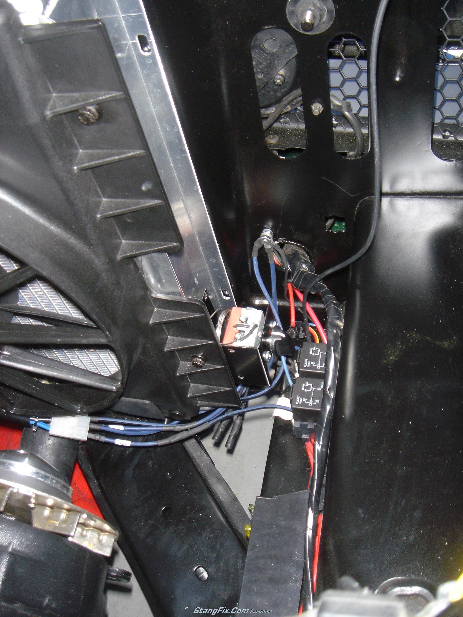

Got the bracket in the mail yesterday for the temp switch. here are some pics, disregard the wiring mess, now that its in I can connect it and clean up the loose wires. Once I get it set I'll probably remove the knob, with the round headed screws I doubt it will stay on very long, either that or I'll replace the round headed screws for some flat headed ones to gain more room for the knob.

so it's an adjustable on/off temp?
Offline Fast68back
  • Posts: 7467
Re: Installed electric fan temp switch last night
« Reply #2 on: March, 25, 2009, 10:56:03 AM »
Honestly, I'm kinda confused by it. There are no indicators on the dial, so I cant set it at a certain temp. I guess I have to let the car run and when it reaches a certain tempurature, I turn the dial until the fan kicks on, once the car is below the temp the fans will kick off.

Be sure to wire the fan relay so that it's only energized with a 12v switched power source.
Offline Fast68back
  • Posts: 7467
« Reply #4 on: March, 25, 2009, 03:07:16 PM »
It is, I ran a keyed source to the dash (plan to hook it up tonight). It was part of the reason I added the painless powerbraid. I didnt want to unwrap the stock harness, so I taped the wire to the harness and then covered it up with the powerbraid.
OK, now that I think about it, is that the right thing to do? Say for example I set the switch to kick on at 180 I drive and get where I'm going and its at 179. I park and turn off the car. Why do newer cars run after you get out of them? If it was constant 12v the fan would run until the car cooled to the shut off temp, no?
