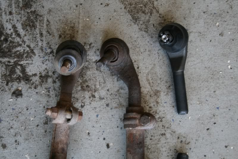

Was comparing the new parts to the old parts and noticed a difference between the old parts and the new parts I have. The new parts for the LH and RH (outer tie rods and inner) are the exact same, but looking at the old ones, they are not the same. One has a different inner tie rod, and the other has a different shaped outer.  Can I still use them or do I have to send the wrong ones back and get the correct ones?  :shrug
Looking at the inner tie rods and this (http://www.mustangsplus.com/xcart/1965-66-Grab-A-Trak-V8-LH-Power-Steer-Inner-Tie-Rod-End.html)
... did Gert originally have power steering?!  :wth

One may be for a car with power steering. Been a while since I compared them. I believe the power steering one will work on manual steering. The bend is to get around the steering power system. Looks like it had power steering.

I'm beginning to believe she did originally come from the factory with PS and sometime down the line (maybe the PO when he was building it to race) removed the PS (maybe it was so badly gone and not worth spending the $ to rebuild or didn't need PS for racing?) and he swapped it to manual.
If so.....  :censored!!!
 Oh well. I'm keeping it manual so since these new parts are for manual steering, I'm guessing I can still use them.

Was your car a 6 cyl originally?  Would that be the difference?
My bet is on power steering though.

As long as all the parts you bought are for the same set-up you're fine...provided you got EVERYTHING new. Tie rod ends (inner and outer), drag link, and idler. Each varies in design if manual or power, six or eight cylinder.

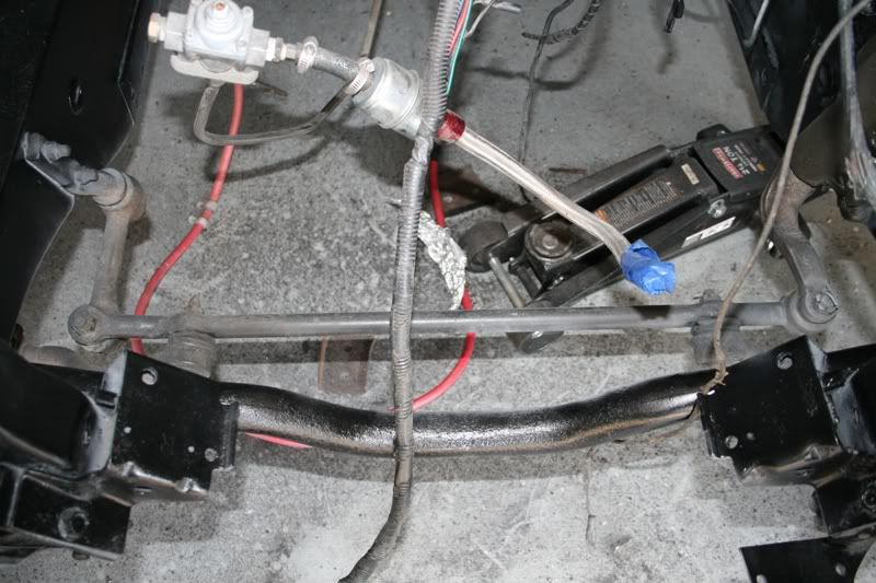

The big difference on the center link is if it has the control valve or not.  If there is no control valve, she has a manual center link.
Should be fine.

This is the center link. Looks like manual one and it doesn't look 40something years old, like it was changed when the PS was changed to MS.

Yep...looks manual to me.....

Looks manual to me too.  Not that Pete needed backup on that.

65/66 Stangs with a V8 did have a unique tie rod end on the driver's side. Like they said your center link is a manual. I don't recall what disc brakes you said you might go with but 70 and later spindles have a different taper. Mustang Steve has adapters if you go that route.

If the car has power steering , you need the correct tie rod on the left side because it can bind against the power steering control valve during excessive cornering/steering.
