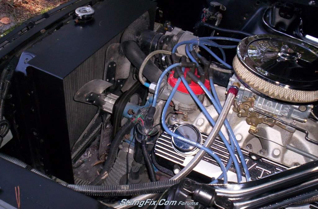

Still in the A/C planning stages. (http://www.stangfix.com/testforum/index.php?topic=860.0) Since I need to change to a reverse flow water pump, is there a difference in the timing chain covers?
Current setup has the normal classic Mustang rotating pump, drivers side lower hose connection, manual fuel pump mount, and front dip stick mounting. (Dang, gotta take an updated pic, wiring changed and neater, different valve covers, coil moved, radiator cap relocated, different air cleaner, new lower hose.....)
