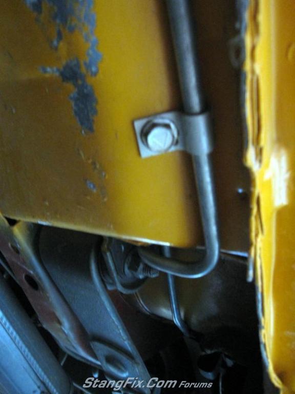

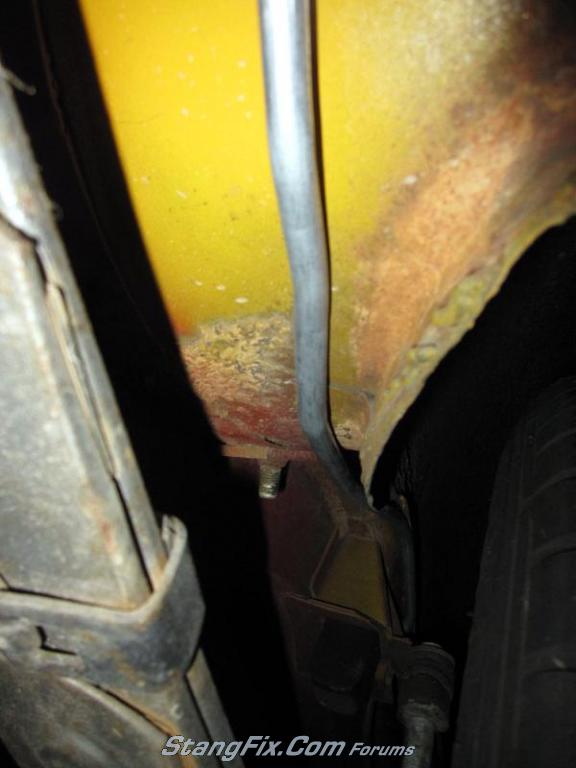

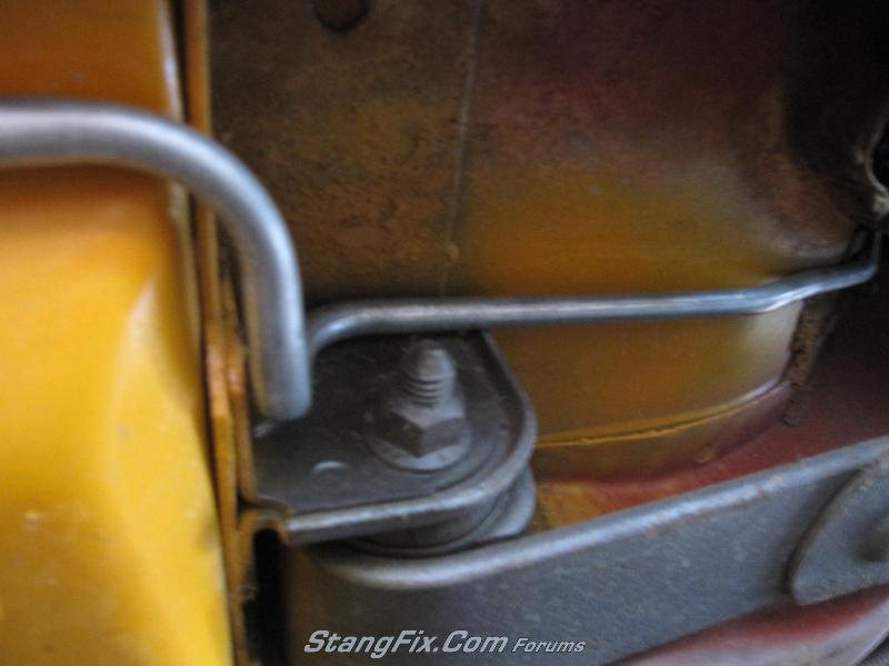

« Reply #4 on: May, 24, 2011, 02:20:53 PM »
Sorry, I didn't see where it was stated that prebent lines weren't being considered. If they aren't, what a chore especially when the fuel line bends up and back near the front of the drivers rear leaf spring.  Hope the pics help.  For the time and agony of frustration I wouldn't think twice but go prebent lines unless there some customizing to the car that will now allow it.
I assume it is known that the front fuel line is one piece from the pump through the torque box stopping a couple inches behind the torque box. It is here where the small piece of rubber connects it to the rear hard line.  Again this is for a 69/70.
Here are some pics of a 69/70 rear hard fuel line on a 70.

Not to completely hijack this thread, nice work on the fuel lines Craig, but I have a question regarding this pic.
That is BM/MT Boss I will assume. What size is that rear sway bar? 5/8 or 3/4? It has been awhile that I have looked at rear sway bars, but the only thing that I ever found was aftermarket bars. I have a 1/2 inch out of a 69 Mach 1 on my 67 Coupe.
