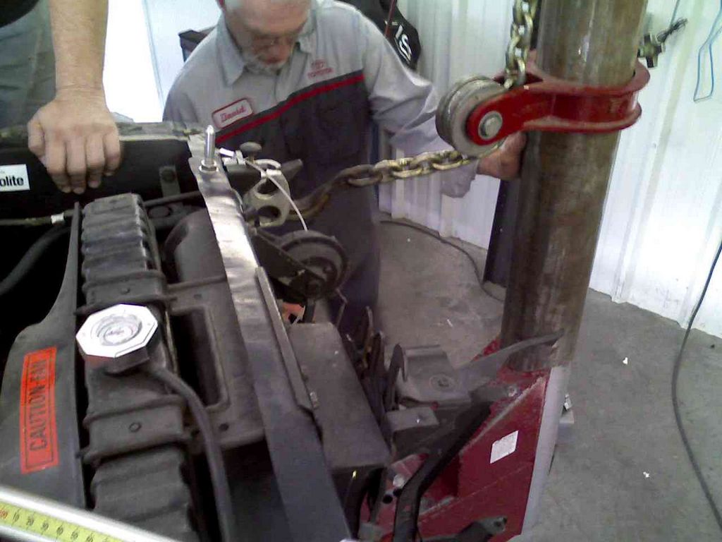

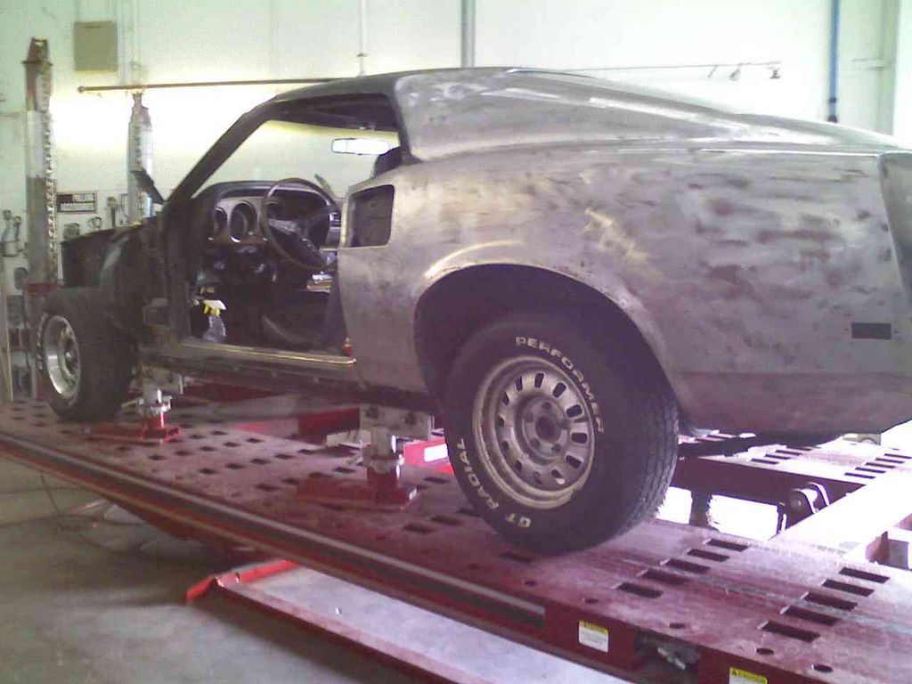

Cell phone pics. They kinda suck :boo
Lookee here:

I've never seen a body straightening in action...wish i was there.
Does the car creak and groan as pressure is applied?

Newer cars made with high strength steel do more so than these oldies, but yes it did groan and pop a bit. It was off about 5/8ths inch, but you have to over pull it a bit so it lands where you want it when the tension is released.
We got it within a 32nd of perfectly square. I'm guessing that's far tighter than factory tolerance.
