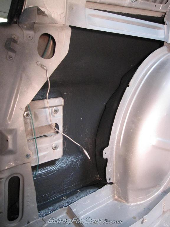

Ok,  Over the next 4-5 days a couple of us will be pretty busy buttoning up Justins car interior sublayer, meaning sound and vibration deadening.  We are using a couple different products from www.secondskinaudio.com.   Doing this will allow his better half to know for sure each time Justin accidently lets one rip. The audio decible level will be frightening to say the least.
In order, here's a couple pics.
Preparing firewall for firewall pad and heater box install.   Applying Second Skin's diamplifier pro vibration dampening material.
Today I applied the first coat of Second Skin's spectrum, roll on , brush on materials in the rear quarter's interiors, a difficult area to apply the diamplifier material.  Tomorrow or Thursday, I will apply a second coat so we end up with a minumum of 1mm coverage.
Once it dries, it will be a mild gray color.  What is nice about this material is that is also protects the metal underneath.
During the next 4-5 days, I will add pics as we go along.

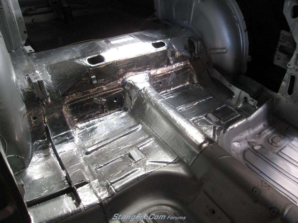

Just a pluggin away.  Spent a couple hours apply 2nd coating of the Spectrum material in the rear quarters as I did yesterday.  I then started apply the damplifier pro onto the interior sheetmetal working from the back, forward.  It's kind of hard to see because the interior is already sort of silverish but if you look closely you can see the very back platform, parts of RH rear and back tunnel is covered.  Hopefully a couple hours of work tomorrow and then Abraham is going to donate 3+ hours to the cause.
Then it dawned on me as I was straddling that tunnel, stretching, and manipulating the foiled material into place.  It's kind of like straddling a woman, giving  her a high demanding deep tissue massage.

mmw68,  I did quite a study of sound and vibration deadening materials which brought me to www.secondskinaudio.com.  They are by far not the cheapest but I liked the information they provided on their website and more importantly they were highly recommended in numerous surveys and forums.
A typical mustang floor is 5x 8  = 40sq ft.  I always go extreme so I'd suggest 60 sq/ft.    You should study up on sound vs thermal vs vibration deadening.  Typically 3 different products.
Today, I finished the back half (under the rear seat).  Afterwards the car and I went out and had a cigarette   :thu

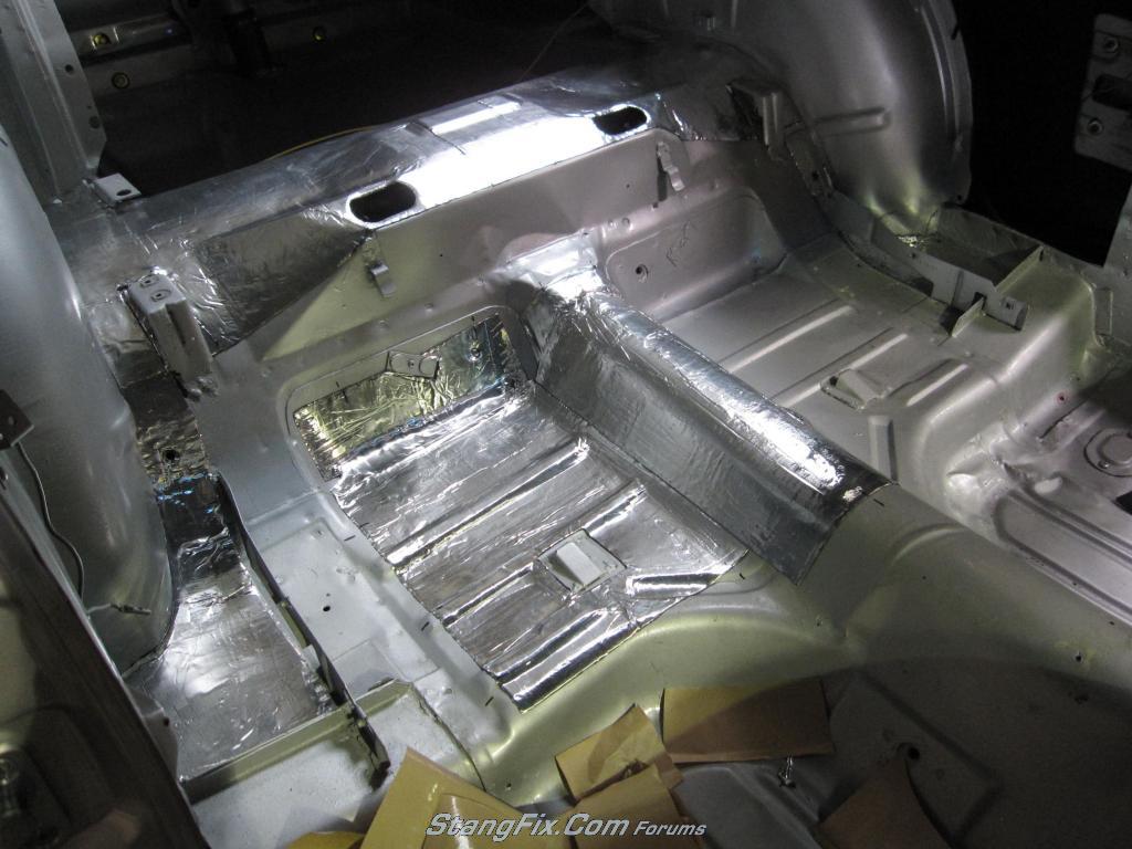

Second Skin's damplifier pro install completed with the help of Abe.  Tomorrow, I think I'll just sit around, drink beer and let everyone else do some work.  I'm pooped.

Justin is aware that he has two options regarding the wheel wells.  As we saw in the beginning of this post, I applied two coats of Second Skin's spectrum on the inside of the rear quarter (front area).  This materials is their roll on, brush on equivilant of the foiled damplifier pro material.
On Shag, I pplied 2 coats of the spectrum throughout the wheel well on the outside surface. Outside meaning same surface as where the rear tires are.  Afterwards I painted the spectrum a nice black for it dries a dark gray.  This is much easier in my opinion as compared to attempting to apply Diamplifier Pro on both sides of same sheet metal.  Another plus is that it gives a nice exterior coating protecting the sheet metal from future rust issues.
