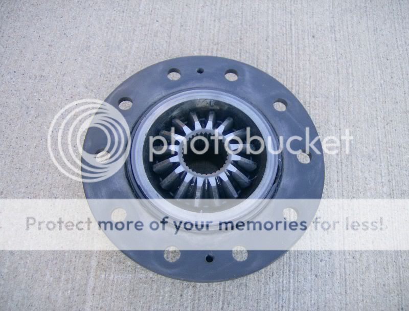

Opened up the rear carrier today. It's definitely an Auburn. No clutches, just 4 spider gears, 8 springs and cone/hub assembly. One of the carrier bearings is a bit chewed up as well, but I didn't get a picture... Ring & pinion look fine.
This isn't good - shaft is bent, chipped and galled on ends. Didn't want to come out...
A few of the broken springs.
Auburn's website says "Inspect the clutch surfaces for galling. If galling has occurred, the cone and cone seat cannot
be reworked." Uh oh...

Time for a true trac locker!
My rear housing and axles are from Currie. The carrier and guts I already had from the previous 9" housing that was too long for the car.
