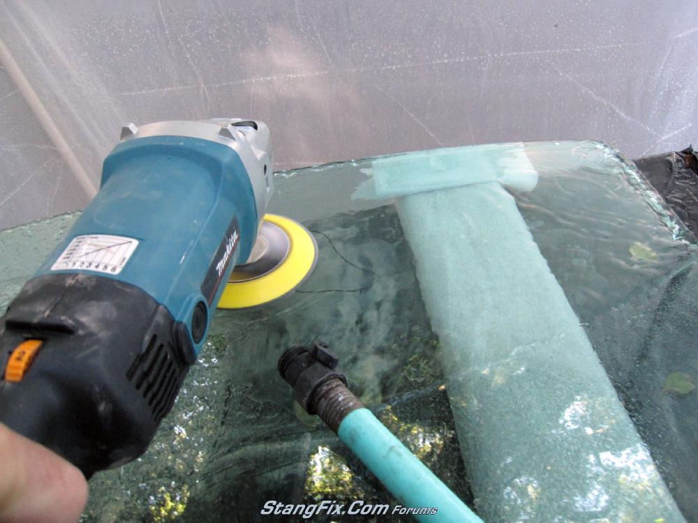

Well this is extremely time consuming to say the least.  After watching my glass guy polish out some scratches on another piece of glass, I recognized the compound and pad as having come from Eastwood products.  Because this compound only polishes the scratches, not necessarily removing them, I needed to look further into actually removing some deep scratches.  Eastwood also sells the deep scratch kit, which contains the polishing kit as well.  The deep scratch kit has 3 different grade abrasive pads which is used to literally sand the scratches out.  You want to start out with the finest grade pad possible to remove the scratches.  If it doesn't work go to a coarser grade.  Once the scratch cannot be felt by your finger nail, step up to the next finer grade pad and finish off with the finest pad. The most important thing is to have running water constantly flood the area to keep the glass cool.

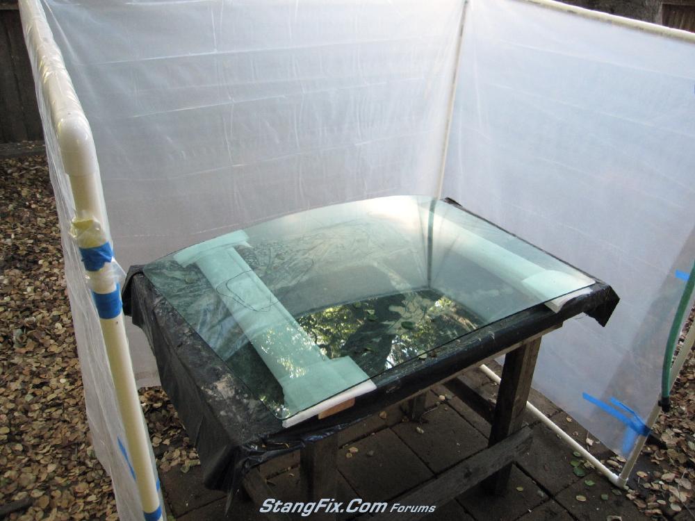

Here's my temp booth which helped prevent the polishing compound from flying all over the yard.  Glass in place.  Note the black circle I marked with a sharpie pen on the bottom side of the glass, circling the area I wanted to address.   This is a must especially when you start using the polishing compound:
Here's a pic using my variable speed polisher set at 800-1200 rpm with water running:

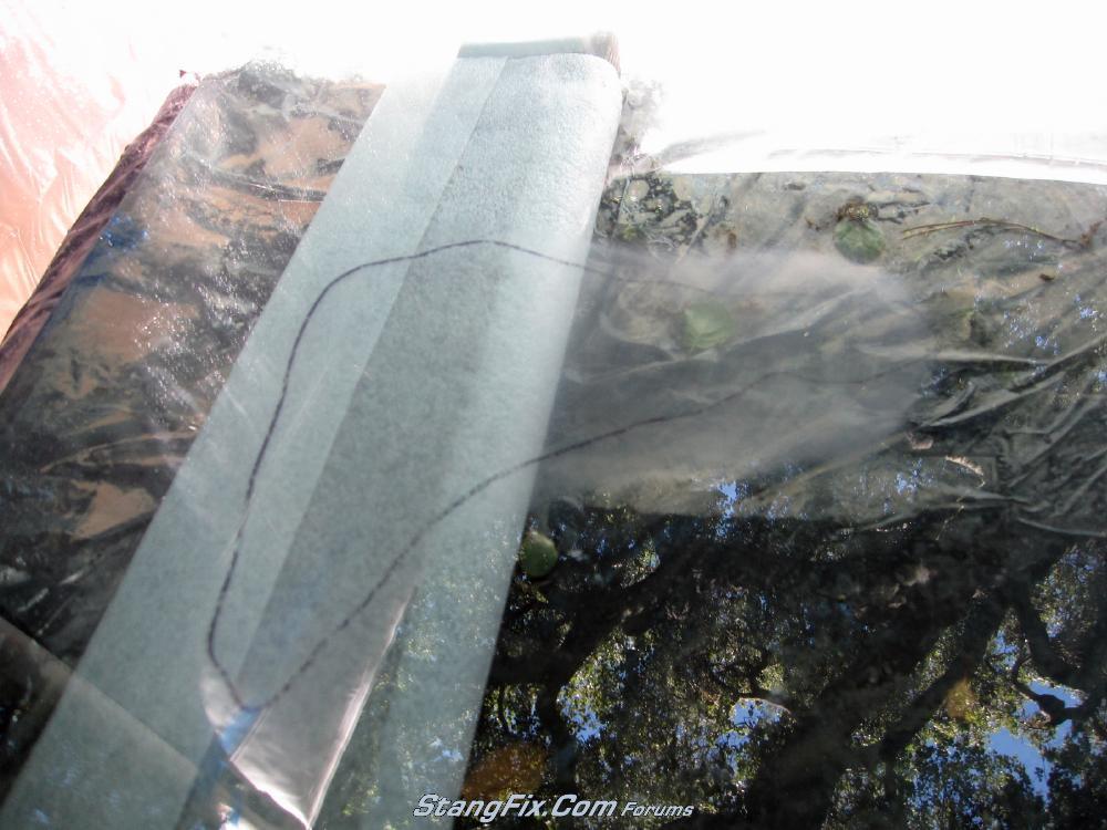

Here's a pic of the fogged area caused by the abrasive pads.  As you can see I did go outside the black circle attacking neighboring scratches.  Keep in mind, the more you scratch, the more fog you need to polish out:

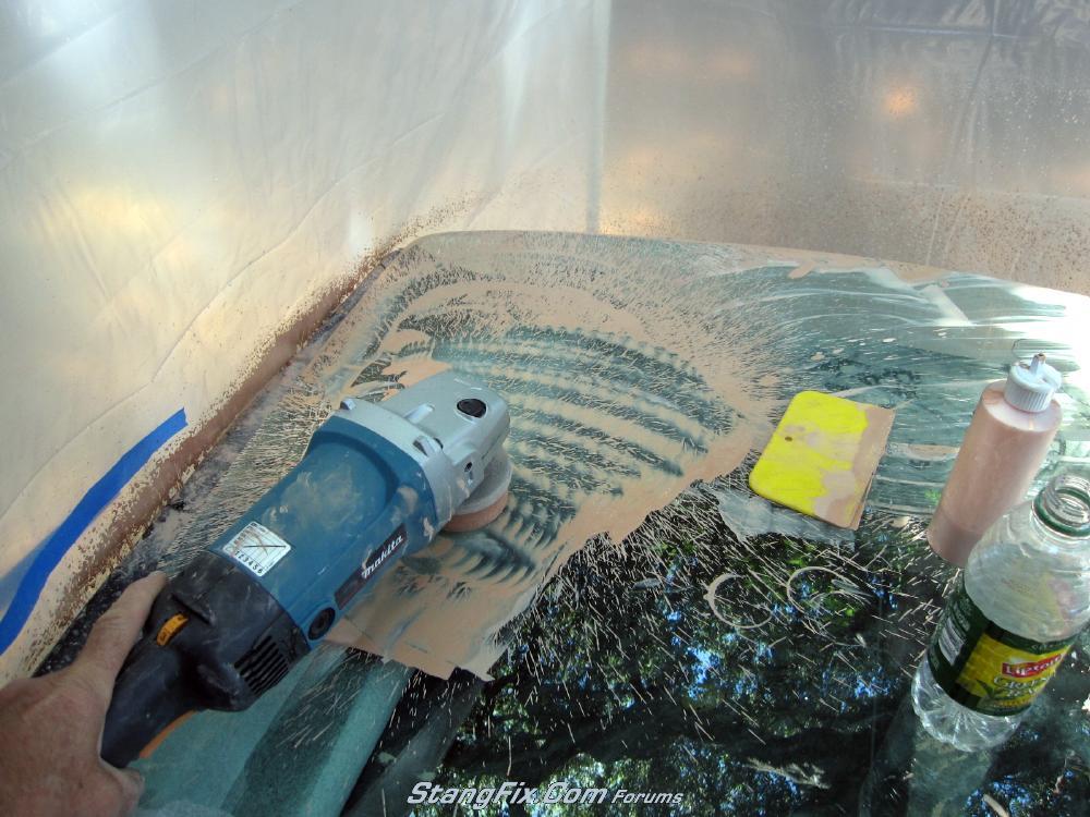

Polishing out the fog using the special pad and compound at a speed of 1200-1500rpm.  This is when having the black circle helps.  Some use bright colored crayons.

I can't imagine doing this to a glass that's installed already.  That would be a big mess.  My goal was only to get the dominating scratches out.  There are still some scratches remaining but nothing I can't live with.  I had to draw the line when to stop.  I estimate it took me 3 hours.
I thought before and after but working under an oak tree, the reflections of such makes it very tough to see especially when taking a pic.
This particular piece of glass is not Shag's original one but another one I got pretty cheap from Craigslist.  It had far less and shallower scratches than Shags.   I still might consider taking on Shags original glass that has some major  but very few very deep scratches, just to see if I can do it.  I even have a 3rd piece of glass which I might take on but it has so many scratches all over the place, I could see 10-12 hours +.
Go to eastwood.com and search for the deep scratch kit.    Wear a mask when using the abrasive pads for this mess puts off some nasty stuff you don't want to get in your lungs.
Prepare for a big mess.  Wear an apron, etc.
