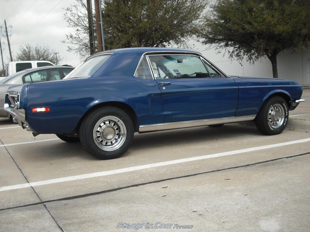

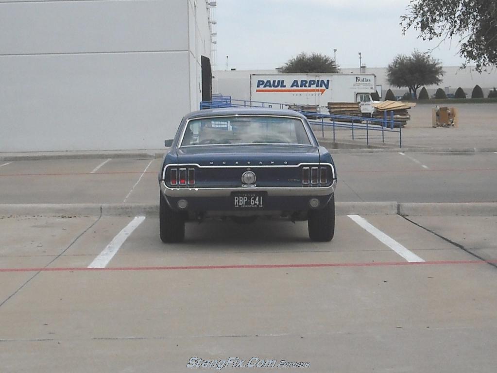

New 15X8 Wheels
New Falken - Z1EX-512 - 235X60X15 Tires They are a little softer than the Road Huggers I was running. I have yet to stomp on it to try out the traction!
I think I would like to lower the stance a couple inches. Just what I need is another project!

That is perfect for your car. So many subtle mods. The wheels are great, bigger and wider but still look factory, and I like the big n little front to back. SWEET. Lowering would be a nice touch. I love your car...
