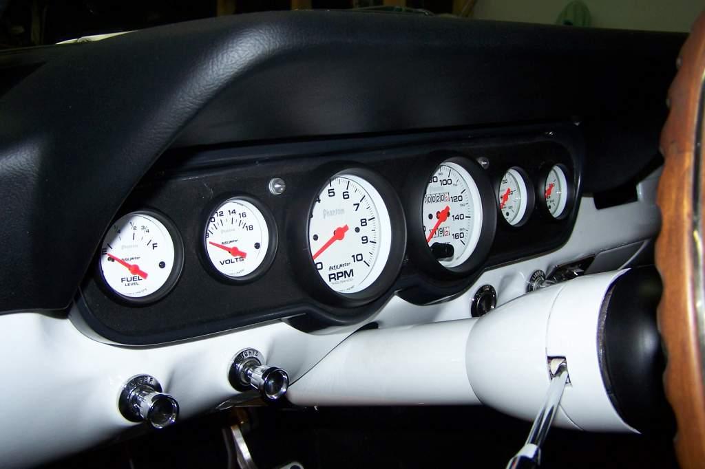

love the instrument cluster

-Six guage instrument cluster w/Autometer Phantom series gauges
